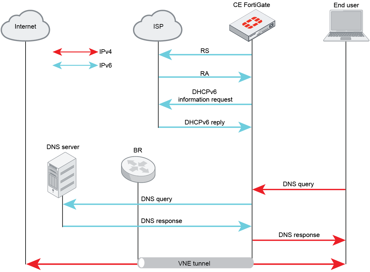

    Initial sequence overview of VNE tunnel under MAP-E mode:
    The FortiGate sends a MAP rule request to the MAP distribution server once the IPv6 address is configured on the FortiGate by RS/RA. Next, the FortiGate will send an AAAA query to get the IPv6 address of the MAP distribution server. After sending the BMR request to the MAP distribution server, the FortiGate will get the IPv4 address, port set, BR IPv6 address, and hostname of the address resolution server from the BMR reply. The VNE tunnel between the FortiGate and BR is now established.
    The address resolution server is actually a dynamic DNS. The hostname is used for the FortiGate to maintain an IPv6 address when it changes.
    The FortiGate updates the DDNS server with its IPv6 address whenever it updates, which in turn provides the update to the MAP distribution server and BR so they know how to resolve the FortiGate by hostname.
    Once the VNE tunnel is established, a tunnel interface is created (vne.root), and an IPv4-over-IPv6 tunnel is set up between the FortiGate and BR. The route, firewall policy, and DNS server can now be configured to let the traffic go through the VNE tunnel and the and protect the end-user. The VNE tunnel can also be used in IPsec phase 1.
