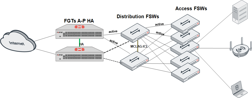

Multiple FortiSwitches in tiers via aggregate interface with MCLAG enabled on all tiers
This example provides a recommended configuration of FortiLink where multi-tier FortiSwitch devices are managed by an A-P mode HA cluster of FortiGates acting as a switch controller via an aggregate interface. The FortiGates provide A-A links to two distribution FortiSwitches that are connected to each other by MCLAG. All access FortiSwitch devices have A-A links with two upper tier FortiSwitches, as long as the MCLAG-ICL has been enabled between the upper tiers.

Enable MCLAG on the ICL link between the distribution FortiSwitch devices:
conf switch trunk
    edit "4DN4K15000008-0"
        set mclag-icl enable
When you enable mclag-icl, MCLAG on the FortiLink interface is enabled automatically and active-active backup links between the distribution FortiSwitches are established.
