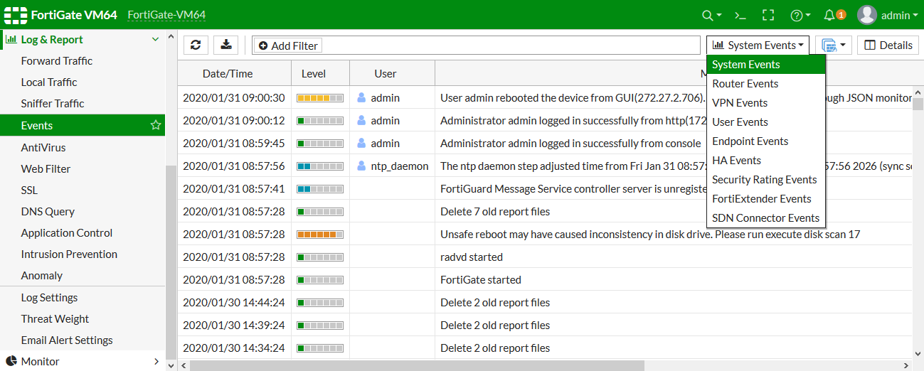

All event log subtypes are available from the event log subtype dropdown list on the Log & Report > Events page. Not all of the event log subtypes are available by default.
System Events
Always available.
Router Events
Always available.
VPN Events
Available when VPN is enabled in System > Feature Visibility.
User Events
Always available.
Endpoint Events
Available when Endpoint Control is enabled in System > Feature Visibility.
HA Events
Always available.
Security Rating Events
Always available, but logs are only generated when a Security Rating License is registered.
WAN Opt. & Cache Events
Available on devices with two hard disks by default. On devices with one hard disk, the disk usage must be set to wanopt and then WAN Opt. & Cache must be enabled in System > Feature Visibility.
WiFi Events
Available on hardware devices when WiFi Controller is enabled in System > Feature Visibility.
FortiExtender Events
Available when FortiExtender is enabled in System > Feature Visibility.
SDN Connector Events
Always available.
