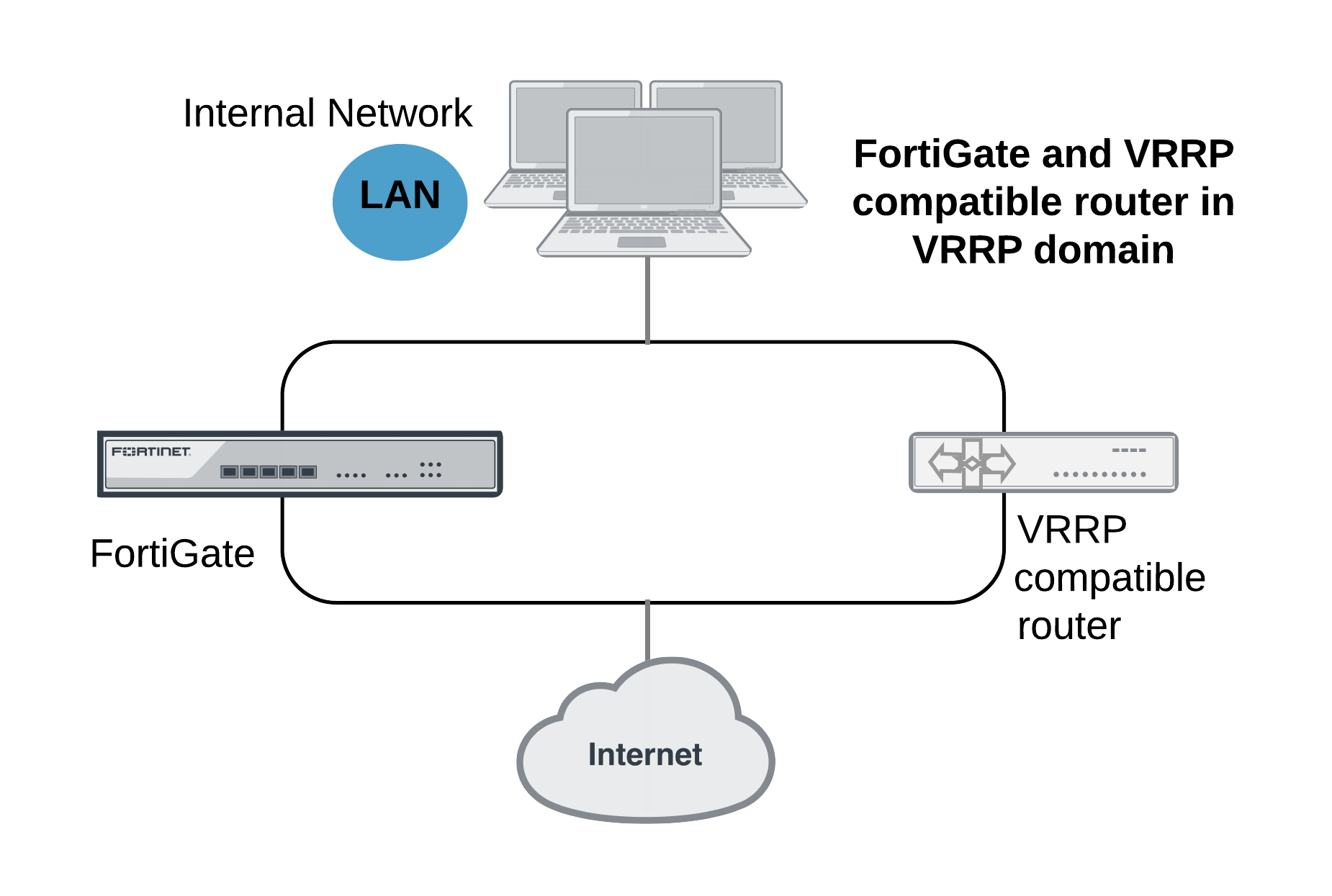

In a VRRP configuration that includes one FortiGate and one router, normally the FortiGate would be the primary router and all traffic would be processed by the FortiGate. If the FortiGate fails, all traffic switches to the router. Network connectivity is maintained even though FortiGate security features are unavailable until the FortiGate is back on line.
