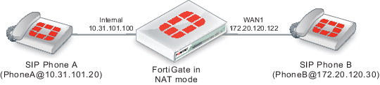

This configuration example shows how to configure the FortiGate to support the source address translation scenario shown below. The FortiGate requires two security policies that accept SIP packets. One to allow SIP Phone A to start a session with SIP Phone B and one to allow SIP Phone B to start a session with SIP Phone A. Both of these policies must include source NAT. In this example the networks are not hidden from each other so destination NAT is not required.
SIP source NAT configuration
General configuration steps
The following general configuration steps are required for this SIP configuration. This example uses the default VoIP profile. The example also includes security policies that specifically allow SIP sessions using UDP port 5060 from Phone A to Phone B and from Phone B to Phone A. In most cases you would have more than two phones so would use more general security policies. Also, you can set the firewall service to ALL to allow traffic other than SIP on UDP port 5060.
  1. Add firewall addresses for Phone A and Phone B.
  2. Add a security policy that accepts SIP sessions initiated by Phone A and includes the default VoIP profile.
  3. Add a security policy that accepts SIP sessions initiated by Phone B and includes the default VoIP profile.

SIP NAT configuration example: source address translation (source NAT)
