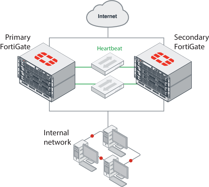

Example FortiGate-7040 HA configuration
In a FortiGate-7000E FGCP HA configuration, the primary (or master) FortiGate-7000E processes all traffic. The secondary FortiGate-7000E operates in hot standby mode. The FGCP synchronizes the configuration, active sessions, routing information, and so on to the secondary FortiGate-7000E. If the primary FortiGate-7000E fails, traffic automatically fails over to the secondary.
