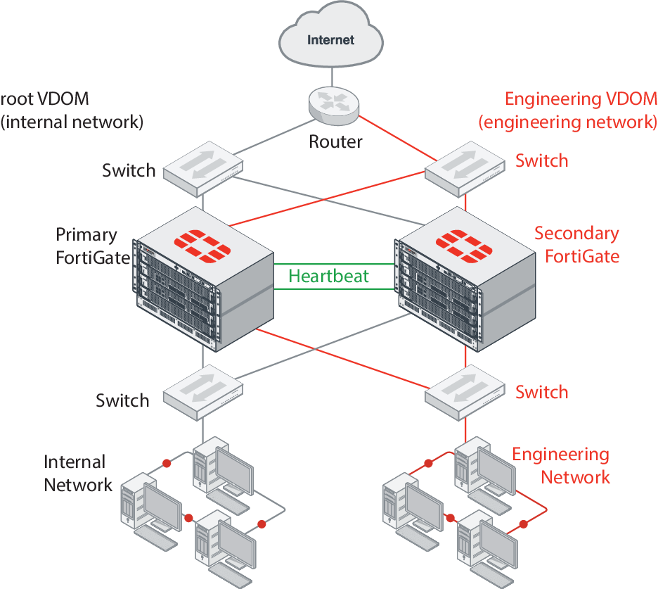

The figure below shows a simple FortiGate-7000E virtual cluster that provides redundancy and failover for two networks. The configuration includes two VDOMs. The root VDOM handles internal network traffic and the Engineering VDOM handles Engineering network traffic. VDOM partitioning has been set up to send all root VDOM traffic to the primary FortiGate and all Engineering VDOM traffic to the secondary FortiGate.

Since the primary FortiGate-7000E has the highest device priority, it processes all traffic for the VDOMs in virtual cluster 1. Since the secondary FortiGate-7000E has the highest virtual cluster 2 device priority, it processes all traffic for the VDOM in virtual cluster 2. The primary FortiGate-7000E configuration adds the VDOMs to virtual cluster 2. All you have to configure on the secondary FortiGate-7000E for virtual cluster 2 is the virtual cluster 2 (or secondary-vcluster) device priority.

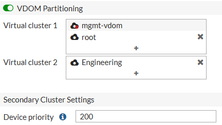

Virtual cluster GUI configuration
From the GUI, you configure virtual clustering from the Global menu by going to System > HA, configuring HA settings and VDOM Partitioning.
Primary FortiGate VDOM partitioning
Secondary FortiGate VDOM partitioning
