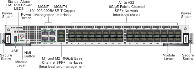

FIM-7901E front panel
FIM-7901E front panel interfaces
You connect the FIM-7901E to your 10Gbps networks using the A1 to A32 front panel SFP+ interfaces. The front panel also includes M1 and M2 SFP+ interfaces for the base channel, four Ethernet management interfaces (MGMT1 to MGMT4), and a USB port. The USB port can be used with any USB key for backing up and restoring configuration files.
| Connector | Type | Speed | Protocol | Description |
| A1 to A32 | SPF+ | 10Gbps/1Gpbs | Ethernet | Thirty-two front panel 10GigE SFP+ fabric channel interfaces. These interfaces are connected to 10Gbps networks to distribute sessions to the FPM processor modules installed in chassis slots 3 and up. These interfaces can also be configured to operate as Gigabit Ethernet interfaces using SFP transceivers. These interfaces also support creating link aggregation groups (LAGs) that can include interfaces from both FIM-7901Es. |
| M1 and M2 | SFP+ | 10Gbps/1Gbps | Ethernet | Two front panel 10GigE SFP+ interfaces that connect to the base backplane channel. These interfaces are used for heartbeat, session sync, and management communication between FIM-7901Es in different chassis. These interfaces can also be configured to operate as Gigabit Ethernet interfaces using SFP transceivers, but should not normally be changed. If you use switches to connect these interfaces, the switch ports should be able to accept packets with a maximum frame size of at least 1526. The M1 and M2 interfaces need to be on different broadcast domains. If M1 and M2 are connected to the same switch, Q-in-Q must be enabled on the switch |
| MGMT1 to MGMT4 | RJ-45 | 10/100/1000Mbps | Ethernet | Four 10/100/1000BASE-T copper out of band management Ethernet interfaces. |
| USB | USB 3.0 Type A | USB 3.0 USB 2.0 | Standard USB connector. |
