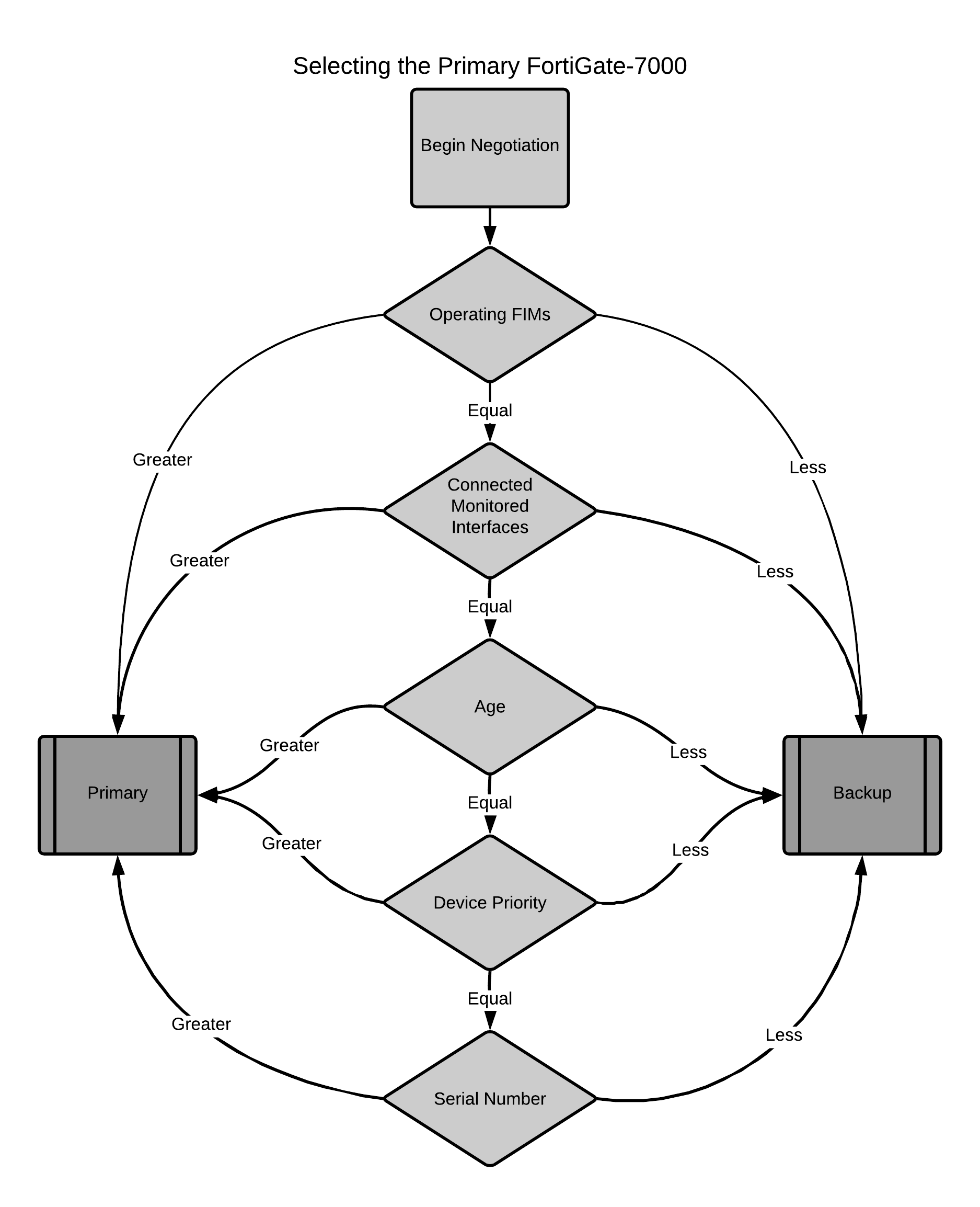

Once two FortiGate-7000s recognize that they can form a cluster, they negotiate to select a primary FortiGate-7000. Primary FortiGate-7000 selection occurs automatically based on the selection criteria shown in the diagram below. After the cluster selects the primary FortiGate-7000, the other FortiGate-7000 becomes the backup.
Negotiation and primary FortiGate-7000 selection also takes place if the one of the criteria for selecting the primary FortiGate-7000 changes. For example, an interface can become disconnected or an FIM can fail. After this happens, the cluster can renegotiate to select a new primary FortiGate-7000 using the same selection criteria.
If there are no FIM failures and if you haven't configured any settings to influence primary FortiGate-7000 selection, the FortiGate-7000 with the highest serial number becomes the primary FortiGate-7000.
This section highlights some aspects of primary FortiGate-7000 selection. For more details about how this works, see Primary unit selection.
