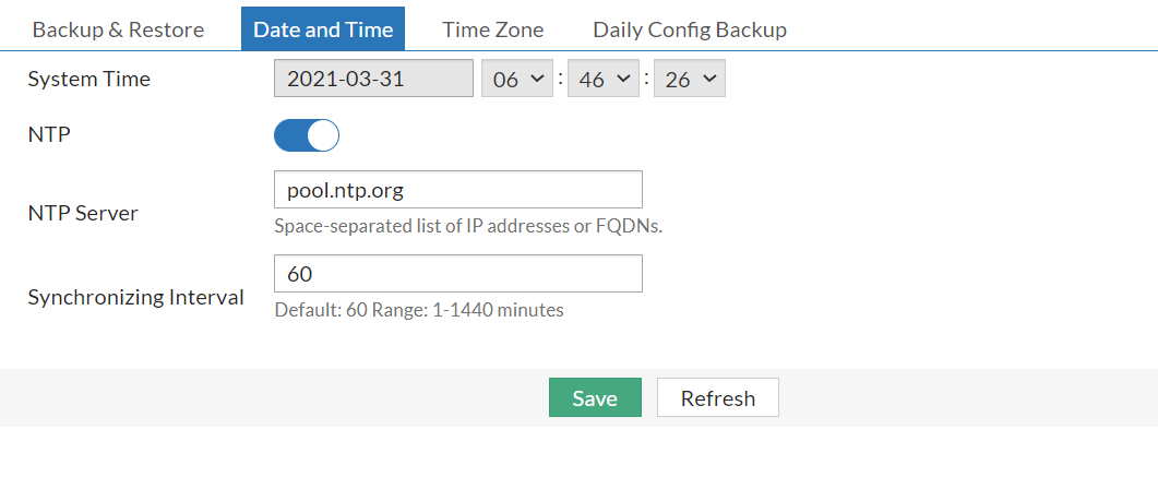

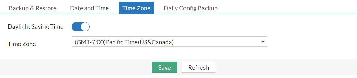

  1. Navigate to the system time settings page in one of the following ways:
  • Go to System > Maintenance > Time Zone.
  • Complete the configuration as described in the table below.
    Important: You can change settings for only one group at a time: Time Zone or Time Setting. You must save your changes after each group before making changes in the next.
  • Save your changes. The system will reboot.
  • Change tabs to Date and Time.
  • Complete NTP or manual time settings.
    • Success — If you manually configured the system time, or if you enabled NTP and the NTP query for the current time succeeds, the new clock time appears in the System Time field at the top of the page shown in the figure below. If the NTP query reply is slow, you might need to wait a couple of seconds, and then click Refresh to update the time displayed in the System Time field.
    • Failure — If the NTP query fails, the system clock continues without adjustment. For example, if the system time had been 3 hours late, the system time is still 3 hours late. To troubleshoot the issue, check settings for your DNS server IP addresses, your NTP server IP address or name, and routing addresses; verify that your firewalls or routers do not block or proxy UDP port 123.

    Time Zone
    Time zone
    1. Ensure the 'Daylight Saving Time' checkbox is unchecked.
    2. Select the time zone where the appliance is located. Check that the GMT offset is correct for the location. In recent years, Time Zone changes have been frequent. If the City/Country-Time Zone pair is inaccurate, use the correct GMT offset and ignore the text information.
    Automatically adjust clock for daylight saving changes Enable if you want the system to adjust its own clock when its time zone changes between daylight saving time (DST) and standard time. When enabled, you will see that the Time Zone GMT offset immediately changes, no matter if you are in DST or not. This is for display only and will not affect the system time.
    Synchronize with NTP Server
    Server Specify the IP address or domain name of an NTP server or pool, such as pool.ntp.org. To find an NTP server, go to http://www.ntp.org. You may enter more than one IP address or domain name with a space between them.
    Sync Interval Specify how often the system should synchronize its time with the NTP server, in minutes. For example, to synchronize once a day, type 1440.

    To configure NTP using the CLI:
    config system time ntp
    set ntpsync enable
    set ntpserver {<server_fqdn> | <server_ipv4>}
    set syncinterval <minutes_int>
