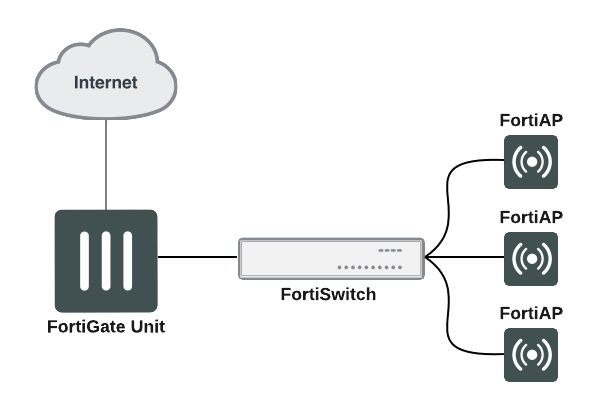

This example uses automatic configuration to set up a basic network using a FortiGate <-> FortiSwitch <-> FortiAP topology.
To configure this network, perform the following tasks:
  1. Configure FortiLink on your FortiGate unit.
  2. Physically connect your FortiSwitch to the FortiGate.
  3. Configure a wireless VLAN for your APs.
  4. Connect your FortiAPs to the FortiSwitch and authorize your FortiAPs from the FortiGate.
