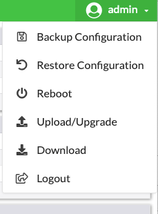

Applying configurations to multiple FortiAPs
If you have multiple FortiAPs that you need to configure, you can save a backup configuration file and use the restore function to apply these configurations to other FortiAPs. In order for this method to work, the firmware version of all your FortiAPs must match.
To apply configurations to multiple FortiAPs
From your FortiAP page, in the top right corner, click to expand the admin menu.
- Click Backup Configuration to save a configuration file.
- Log in to the FortiAP page that you want to apply to configuration to.
- Click to expand the admin menu.
- Click Restore Configuration and select the configuration file you created.
