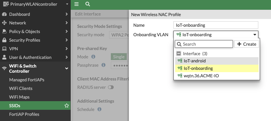

Add The FortiLink NAC Policy to the PSK SSID
Return to the IoT/PSK only SSID.
  1. Go to WiFi & Switch Controller > SSIDs.
  2. Double-click on the IoT/PSK only SSID.

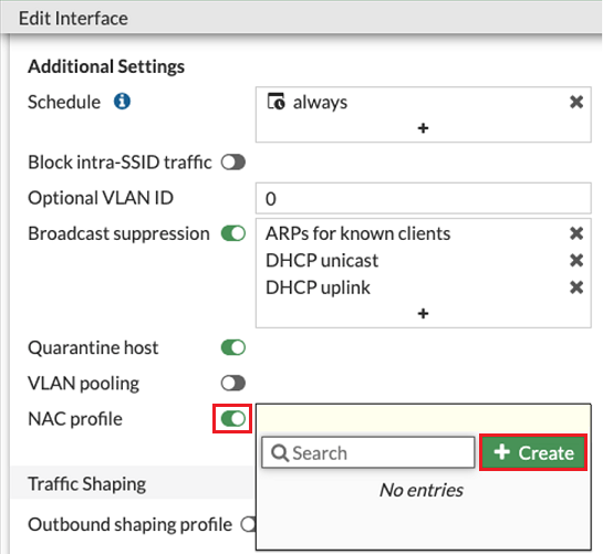

  3. Enable NAC profile and click Create.
    The New Wireless NAC Profile screen appears.
  4. Enter a profile Name.
  5. In Onboarding VLAN, select the VLAN you previously defined.
  6. Click OK.
  7. In the SSID Edit Interface screen, confirm the NAC profile is enabled and that the onboarding profile is correct.
  8. Click OK.
