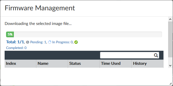

  2. In the System Information widget, beside Firmware Version, click Update Firmware.
    The Firmware Management dialog box opens.
  3. Before upgrading your firmware, you can choose to enable or disable Backup Configuration. When this setting is enabled, you will automatically download a backup copy of your FortiAnalyzer configuration when performing a firmware upgrade.
    If you want to encrypt the backup file, enable Encryption, then type and confirm the password you want to use. The password can be a maximum of 63 characters.
  4. From the FortiGuard Firmware box, select the version of FortiAnalyzer for the upgrade, and click OK.
    The FortiGuard Firmware box displays all FortiAnalyzer firmware images available for upgrade. A green checkmark displays beside the recommended image for FortiAnalyzer upgrade.
    If you select an image without a green checkmark, a confirmation dialog box is displayed. Click OK to continue.
    FortiAnalyzer downloads the firmware image from FortiGuard.
    FortiAnalyzer uses the downloaded image to update its firmware, and then restarts.
