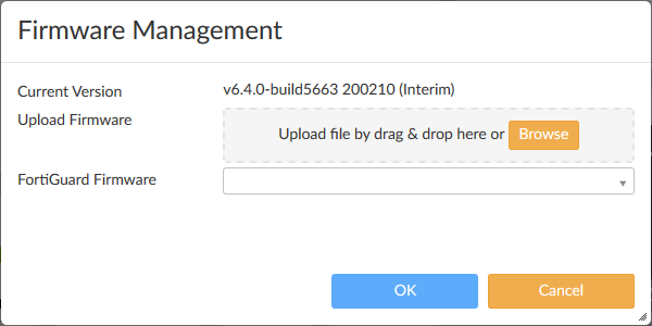

To upgrade firmware using FortiGuard:
  1. Go to System Settings > Dashboard.
  2. In the System Information widget, go to the Firmware Version field, and click the Upgrade Firmware icon.
  3. In the FortiGuard Firmware list, select the version of FortiAnalyzer for upgrade, and click OK.
    The FortiGuard Firmware box displays all FortiManager firmware images available for upgrade. A green checkmark displays beside the recommended image for FortiAnalyzer upgrade.
    If you select an image without a green checkmark, a confirmation dialog box is displayed. Click OK to continue.
    FortiAnalyzer downloads the firmware image from FortiGuard.
    FortiAnalyzer uses the downloaded image to update its firmware, and then restarts.
    It is recommended to view the console log output during upgrade. See Checking FortiAnalyzer log output.
  4. When the login window displays, log into FortiAnalyzer.
  5. When the upgrade completes, you might have to refresh your web browser to see the login window.
  6. If the database needs rebuilding, you can monitor the rebuild status by double-clicking the Rebuilding DB status in the toolbar.
    The rebuild process includes two steps. When it’s done, you see the Rebuilding log database was completed message.
  7. Some features are unavailable while the SQL database is rebuilding.
  8. Review the System Settings > Event Log for any additional errors. See Checking FortiAnalyzer events.
To upgrade firmware using an image downloaded from the Customer Service & Support portal:
  3. In the Firmware Upload dialog box, click Browse to locate the firmware package (.out file) that you downloaded from the Customer Service & Support portal, and click Open.
  4. Click OK.
    The firmware image is uploaded. When the upgrade completes, a message confirms a successful upgrade.
  5. When the login window displays, log into FortiAnalyzer.
  6. When the upgrade completes, you might have to refresh your web browser to see the login window.
  7. If the database needs rebuilding, you can monitor the rebuild status by double-clicking the Rebuilding DB status in the toolbar.
  8. Some features are unavailable while the SQL database is rebuilding.
  9. Review the System Settings > Event Log for any additional errors. See Checking FortiAnalyzer events.
  4. Click OK.
