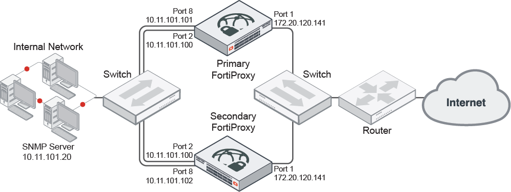

Configuration example
This example describes how to configure SNMP remote management of individual cluster units using an HA reserved management interface. The configuration consists of two FortiProxy units already operating as a cluster.
Two FortiProxy units are already operating in a cluster. On each unit, port8 is connected to the internal network through a switch and configured as an out-of-band reserved management interface.
Administrative access and default route for HA management interface
To configure the primary unit's reserved management interface, configure an IP address and management access on port8. Then, configure the necessary HA settings to enable the HA reserved management interface and its route.
To configure the secondary unit's reserved management interface, access the unit's CLI through the primary unit, and configure an IP address, management access on port8, and the necessary HA settings. Configuration changes to the reserved management interface are not synchronized to other cluster units.
To configure the primary unit reserved management interface in CLI:
  1. From a computer on the internal network, connect to the CLI at 10.11.101.100 on port2.

            set name "Community"
            config hosts
                    set ip 10.11.101.20 255.255.255.255
                    set ha-direct enable
    Enabling ha-direct in a non-HA environment will make SNMP unusable.
  2. Add an SNMP user for the reserved management interface:
    config system snmp user
        edit "1"
            set notify-hosts 10.11.101.20
  3. Configure remaining settings as required.
To get CPU, memory, and network usage information from the SNMP manager for each cluster unit using the reserved management IP addresses:
  1. Connect to the SNMP manager CLI.
  2. Get resource usage information for the primary unit using the MIB fields:
    snmpget -v2c -c Community 10.11.101.101 fgHaStatsCpuUsage
    snmpget -v2c -c Community 10.11.101.101 fgHaStatsMemUsage
    snmpget -v2c -c Community 10.11.101.101 fgHaStatsNetUsage
  3. Get resource usage information for the primary unit using the OIDs:
    snmpget -v2c -c Community 10.11.101.101 1.3.6.1.4.1.12356.101.13.2.1.1.3.1
    snmpget -v2c -c Community 10.11.101.101 1.3.6.1.4.1.12356.101.13.2.1.1.4.1
    snmpget -v2c -c Community 10.11.101.101 1.3.6.1.4.1.12356.101.13.2.1.1.5.1
  4. Get resource usage information for the secondary unit using the MIB fields:
    snmpget -v2c -c Community 10.11.101.102 fgHaStatsCpuUsage
    snmpget -v2c -c Community 10.11.101.102 fgHaStatsMemUsage
    snmpget -v2c -c Community 10.11.101.102 fgHaStatsNetUsage
  5. Get resource usage information for the primary unit using the OIDs:
    snmpget -v2c -c Community 10.11.101.102 1.3.6.1.4.1.12356.101.13.2.1.1.3.1
    snmpget -v2c -c Community 10.11.101.102 1.3.6.1.4.1.12356.101.13.2.1.1.4.1
    snmpget -v2c -c Community 10.11.101.102 1.3.6.1.4.1.12356.101.13.2.1.1.5.1
