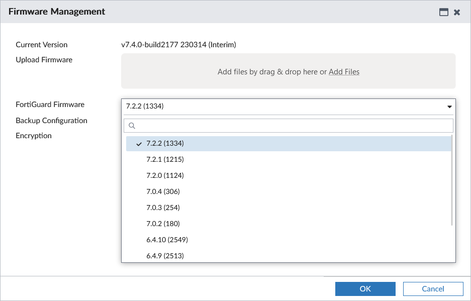

  4. From the FortiGuard Firmware box, select the version of FortiAnalyzer for the upgrade, and click OK.
    The FortiGuard Firmware box displays the FortiAnalyzer firmware images available for upgrade:
    • When FortiAnalyzer has a valid contract, all available firmware versions are displayed for upgrading or downgrading.
    • When FortiAnalyzer has no valid contract, or the contract is expired, only display the available patch upgrades.
    • A green checkmark displays beside the recommended image for FortiAnalyzer upgrade.

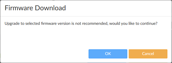

    • If you select an image without a green checkmark, a confirmation dialog box is displayed. Click OK to continue.

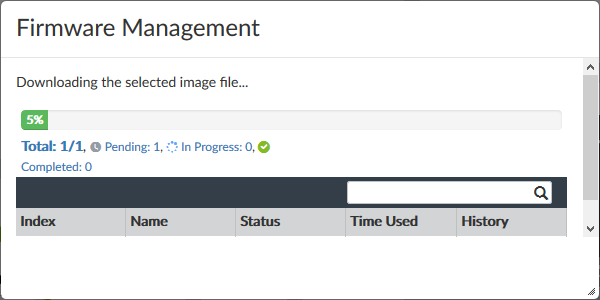

    • FortiAnalyzer downloads the firmware image from FortiGuard.

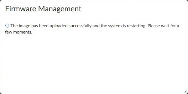

    • FortiAnalyzer uses the downloaded image to update its firmware, and then restarts.
    • After FortiAnalyzer restarts, the upgrade is complete.
