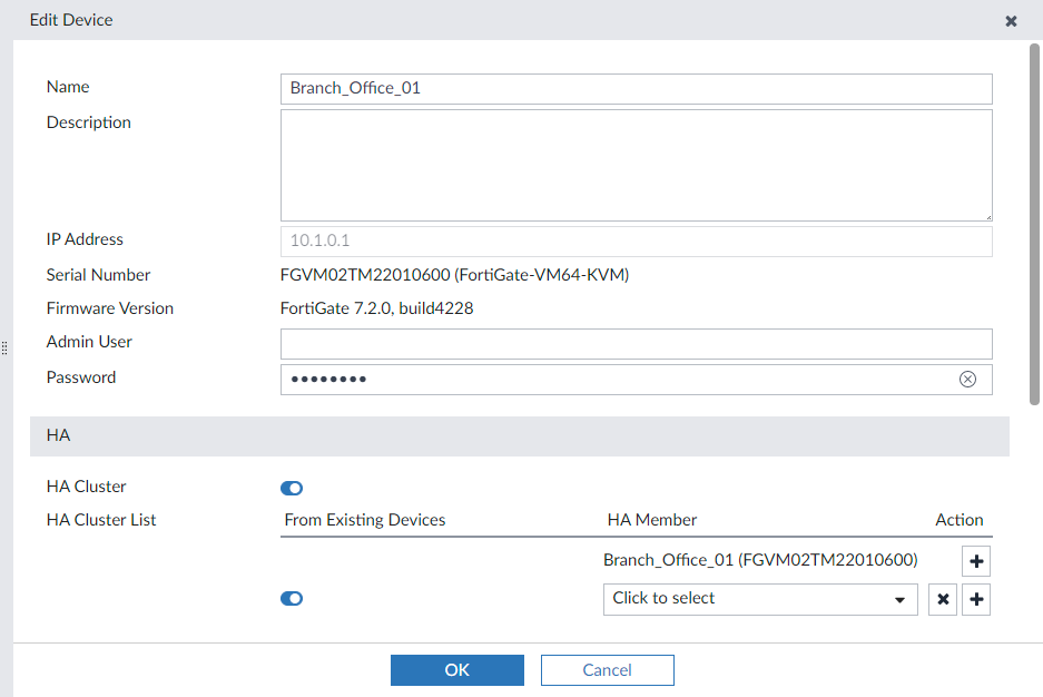

To create a HA cluster:
- If using ADOMs, ensure that you are in the correct ADOM.
- Add the devices to the Device Manager.
- Choose a primary device, and click Edit.
- In the Edit Device pane, enable HA Cluster.
- In the Action column, click the Add icon.
- In the Add Existing Device column, enable the toggle to select an existing device from the dropdown.
Alternatively, you can disable the toggle and enter the Serial Number of the device.
Adding the devices before you create the HA is recommended.
- Add more devices to the HA cluster as necessary, and click OK.
The maximum is three backup devices.
To view the HA in the Device Manager, click Column Settings > HA Status.
