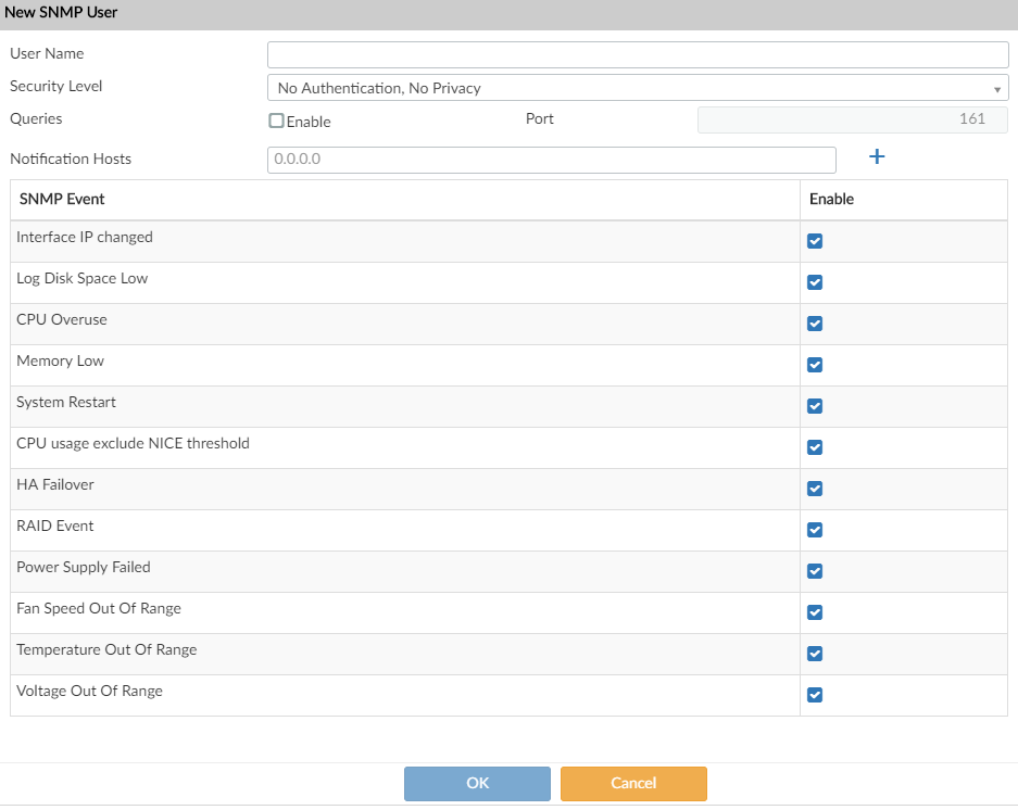

The FortiAnalyzer SNMP v3 implementation includes support for queries, traps, authentication, and privacy. SNMP v3 users can be created, edited, and deleted as required.
To create a new SNMP user:
- Go to System Settings > Advanced > SNMP and ensure the SNMP agent is enabled.
- In the SNMP v3 section, click Create New in the toolbar. The New SNMP User pane opens.
- Configure the following options, then click OK to create the community.
User Name
The name of the SNMP v3 user.
Security Level
The security level of the user. Select one of the following:
- No Authentication, No Privacy
- Authentication, No Privacy: Select the Authentication Algorithm (SHA1, MD5) and enter the password.
- Authentication, Privacy: Select the Authentication Algorithm (SHA1, MD5), the Private Algorithm (AES, DES), and enter the passwords.
Queries
Select to enable queries then enter the port number. The default port is 161.
Notification Hosts
The IP address or addresses of the host. Click the add icon to add multiple IP addresses.
SNMP Event
Enable the events that will cause SNMP traps to be sent to the SNMP manager.
- Interface IP changed
- Log disk space low
- CPU Overuse
- Memory Low
- System Restart
- CPU usage exclude NICE threshold
- RAID Event (only available for devices that support RAID)
- Power Supply Failed (only available on supported hardware devices)
- High licensed device quota
- High licensed log GB/day
- Log Alert
- Log Rate
- Data Rate
- Fan Speed Out of Range
- Temperature Out of Range
- Voltage Out of Range
FortiAnalyzer feature set SNMP events:
